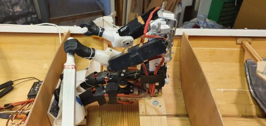

Thanks for the input. The things he has been talking about are.
1.To install gyro in the arm servos. When the boat rolls side to side, the oars are just at the same deep in the water on both side, at least not become loose from the lake.
2. Made one mode. That he stops to row the boat and drives the oars up from the lake and the boat lays still.
3. And to build a servo in the head so it can go from side to side.
Then we'll see what happens
