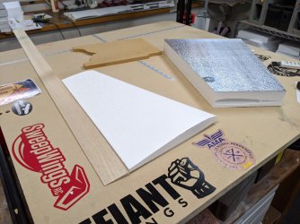

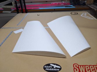

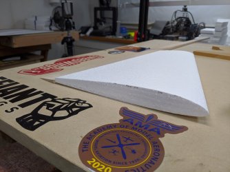

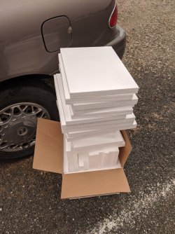

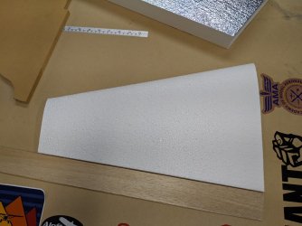

Yes, its a medical facility. So pharmacy, medical, dental etc. We get stuff in those huge coolers and than smaller boxes that come made out of 6 nice rectangles of foam already.
Its 1" thick, which is good for small wings and building up fuselages.
##edit: Its super rigid stuff, like the pink stuff

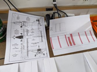

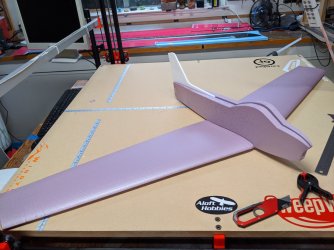

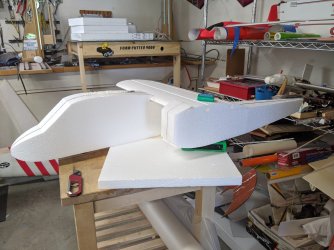

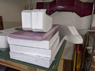

Yeah i printed out a bunch of printer paper with the Pilatus pc-6 fuselage plans fullscale on them. I'm going to glue a bunch of this foam together and trace out the top and sides of the fuse and than slice that in half on the CNC so i get the opposite side.

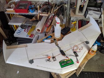

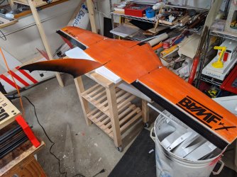

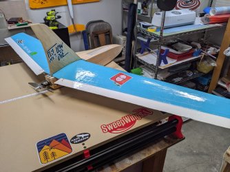

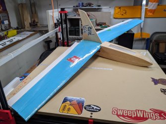

@Konrad Sorry it wasnt much to speak about, didnt get any video. Really bad conditions on a bad hill. Was special to me as i haven't been out flying in months from the non stop smoke. But the fact that i was able to control it in such bad conditions tells me cg was pretty darn close and will probably do great in a better situation. This was also a test of half length controls, on my past 2 planks i did full span, really happy with how it did and can't wait to try it out in some good wind. This build was mainly a test of cg, the full build i am putting a ballast tube in.
Ok, bad conditions really don't allow for a comprehensive test. I understand the smoke issues! I too haven't been flying, with the usual results in lost airframes from lack of practice.
