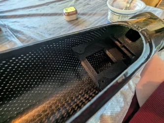

Starting to figure out the build. Are there any build logs/threads you would recommend checking out?
I'm not totally clear on how to assemble the servo tray and where it is supposed to sit in the fuse.

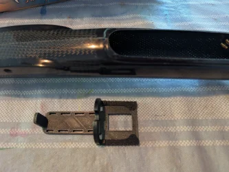

Seems like it is about like this. Still trying to figure out the cable rooting though.
I'm guessing the cables are supposed to be strapped to the backside of the servo tray, is that right? If not, what is the backside for?

Please let me know if you find it. I'm still not sure what that rectangle piece is for.

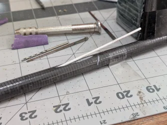

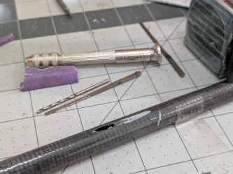

I got through cutting this little slot this morning. Was a little fiddly. If someone else finds it helpful, I took the following steps.
1) I attached the vertical stabilizer first, as I felt like it could be difficult to both align it to the horizontal and make sure it is fully seated at the same time. This made cutting the notch for the elevator control a little harder.
2) attached horiz stab to mount and marked how far forward the mount needs to be with paint pen.
3) Marked area on tube around where slot needs to be with paint pen, placed mount on tube using mark from (2), and by hand slotted a small drill bit through the mount to scrape the paint where the slot should start
4) drilled a small pilot hole just in front of where paint was scraped.
5) used drill bit, a bit of a jig saw blade, and sand paper to lengthen slot; remarking like (3) as needed until bowden fit without kinking.
6) sanded and cleaned carbon tube to prepfor glueing.
7) remounted horiz. stab to allow alignment for final glue up.
I am using gflex epoxy for the glue. I have used it on other things and it gives a really durable joint that won't crack. It maybe just needs a little more attention to avoid adding extra weight. It also gives a lot more time to mess around with alignment than CA.

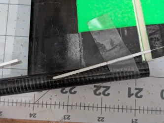

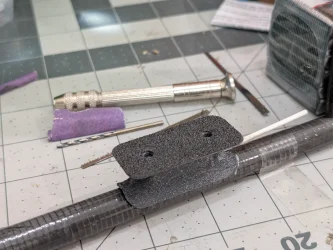

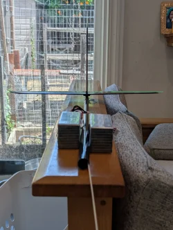

I hope I have the right spacing between the elevator and rudder. I could only guess by eyeballing some of the photos I found online.
It looked like they are often built with about a finger width between the two.
I'm guessing it is fine as long as they aren't rubbing.
BTW, I still don't know what the rectangular piece is for.

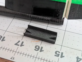

I'm also not sure what this piece is for.
I'm told this is a brace to keep the 6 pin connector from being pushed into the fuselage when installing the wings at the field.
Same person thinks you may have the servo tray and bulkhead upside down relative to one another.

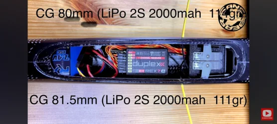

For the bulkhead and servo arrangement, I was basing it off of the DJango Bubble video, though you can't fully see the bulkead. The video is showing a pre built glider, but I don't know if VP or someone else built it.

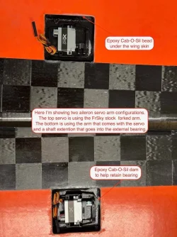

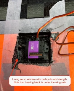

From Konrad:
Yes, the Bowden tubes are encapsulated in the slots after their location is found using the 5mm or 6mm servo arms. I’d like to see that there be an undercutting of the wing skin to allow the formation of an epoxy bead between the lower skin and servo well liner (servo mount). Also suggest that the flap push rods be manufactured with over ride springs.

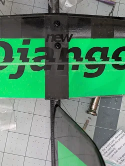

I also mounted some of the control horns today, but only documented the slot for the rudder bowden.
Position of the slot is based on the pre built Bubble Glider video on YouTube.
Will try to remember to document one of the other control horns.

I think the linkage for a spring override pushrod would need a hook between the two haves that would allow the servos to positively engage when pulling flaps down, but compress when pushing flaps up.
If using a simple zbent music wire, I think a similar result could be achieved by putting a slight curve on the wire, so it will be inclined to bow when pushing the flap up.
Though I don't think the Django has a hard stop on pushing flaps up, so maybe not really a problem. Also, the KST servo end points can be programmed to provide further protection against over extension.
Oh. I see now that he did that to protect the servo if the flap catches during landing. Interesting.
KST says that the x08 plus is supposed to have an improved gear train. I guess I will test that and consider the spring override if necessary. I'm somewhat worried that poorly executing that concept could be catastrophic.
