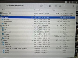

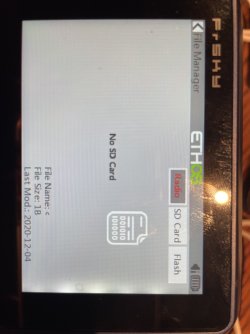

New user. Love my radio. I tried to add an SD card using my MacBook Pro. In finder it shows two drives called no-name and my SD card. I’ve tried copying files to the SD card and adding images. I’ve been unable to make it work. Now it appears I’ve lost, my model settings in one of the drives. I can’t seem to find out what is supposed to be in each of the drives? I’ve removed the SD card and when I go into model select, the radio file is blank and there’s also a flash option. Also, when I turn off my radio, I lose the settings on my model to use the external adapter.

Couple of thoughts..
Did you navigate into a sub folder via Ethos?
Macs like to add some jibber jabber to drives that they have been tasked to work with. Sometimes this jibber jabber causes issues. But I don't think that is the issue here, I suspect you made a mistake and killed some files.
