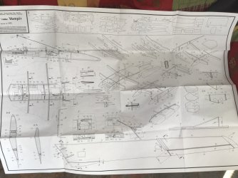

Have this. Lemme know if you need any info referenced.
Oh dude! my fuselage and wing joiners are really messed up on mine from the last owner and I am not looking forward to repairing it LOL Is there a way I could get a copy of the plans? Maybe buy the kit off you even?
I would think, a long with a copy of the plans a shot of the parts sheet with the fuse parts and a scale bar would help.

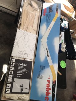

Here is a quick shot of the exploded view included. Not sure exactly what your looking for,ask away. Thought I could unpack and trace any parts you needed help with ,but can see all parts are still in lite vac plastic packing. The kit has obviously never been unpacked-I’ve never looked at it in detail before…

After some searching around, I managed to find a kit....In the UK. Call me crazy, but I grabbed it and it's now on the way. The plan is to use the parts and plans to build a new fuselage as the one I have is broken in half and I can't be bothered to put it back together, it's a total write off.
Are you going to use the kit parts as templets to make a replacement fuselage for your original aircraft? Maybe use this opportunity to enhance the design making the plywood blade joiners out of a more suitable modern material.
well yeah, I was hoping to use carbon fiber plate.
