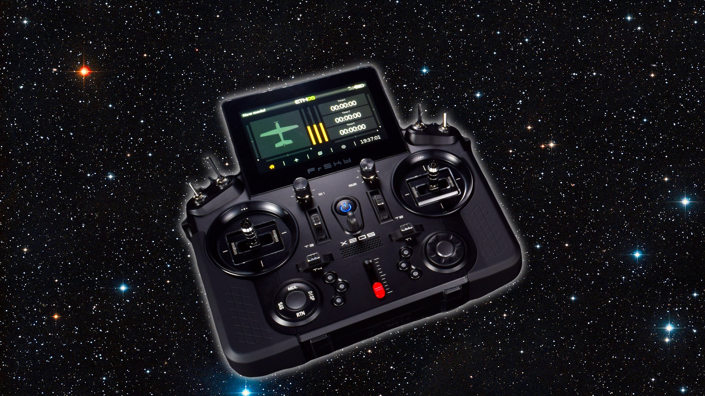

Another thing you could try if you really want to get your hands dirty, the new FrSky X20 radios offer both 2.4ghz and 900mhz bands. You can setup your plane to use both frequencies to help combat the ignition noise. I would think this would be an added benefit, but I also understand that the ignition noise can and will saturate a very wide range of frequencies, so both the 2.4 and the 900 may have a tough time with an engine that is really dirty.
If you would like to give the FrSky world a try I'd suggest these items:
and
This should be a good combo. The X20 is a pretty easy radio to use compared to some of the other Frsky radios, and the R8-Pro receiver has the extra filtering to help fight ignition noise.
