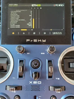

I've had this model for a few years, and no issues on reception etc. I was flying a few easy circuits to test. VFR was at it's lowest 96%. RSSI did drop to 50ish. While flying the model did a left roll, I was without any control, and crashed at good speed.
I've attached the log file, looks like the incident happened at 15:29. Anything I can get from this what might have happened?

Attached the stats output while looking at the RX on my bench.
