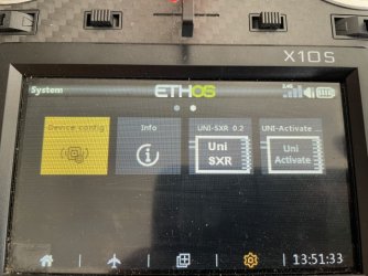

I just went from opentx to ethos on x10s and x12s.
Uni Activate and Uni sxr scripts are working fine and are shown on the last page of the SYS menu.
Uni Stat runs as a widget on a full screen.
But i can’t find out how to run the settings script.

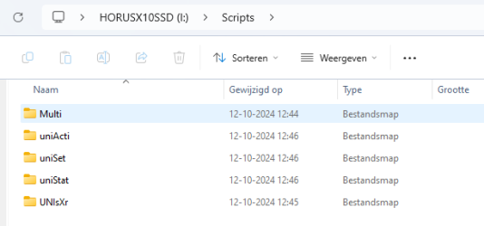

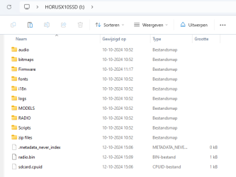

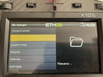

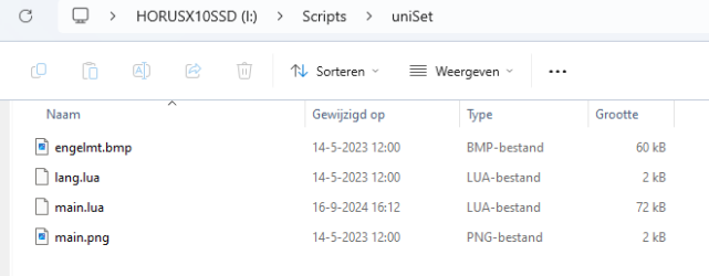

@mike, no luck with the files you posted above.
As an Ethos beginner, I must be doing something wrong. As everything works under Opentx.
I added printscreens of ssdcard and xz10s display
Should UniSet also be displayed under 'system'? Or should it be run otherwise?

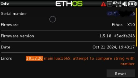

The uniset 2 beta2 script now displays however it is still showing an error.
