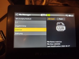

OK, I have redownloaded all the correct files and setup in the correct folders. Flashed the receiver again with the firmware. Radio started normally with no popups. Receiver did bind but nothing came up for the activation code. Am I supposed to turn on Lua scripts some place or do they automatically activate? I have downloaded the
main.lua
I can open all 3 in notepad so they are not zip files and have the proper extensions on the end. Radio is an X20S.

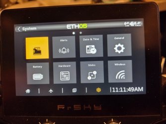

In Ethos if you did things correctly the Uni-Activate will pop up in your system menus. (just click the SYS key, then scroll to the left.)

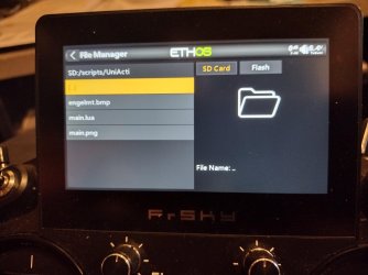

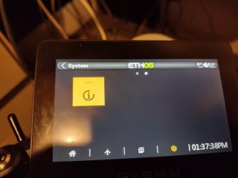

I don't know what I might have done wrong. Here is what I get in the system. I made sure all the extensions are correct. I tried to attach the main lua file but it won't allow me too. My guess is that I'm doing something wrong.

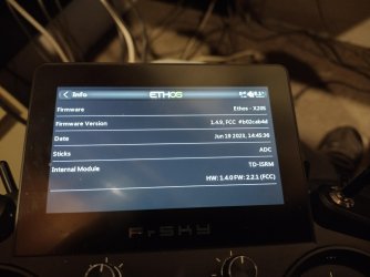

The only thing on that page is info. This is all that shows in info. I have checked another model and it is the same. Do I have something missing in my radio program?

Ok after continual loading of the Lua downloads, I now have the Lua widgits and when I go into it things light up. Now I found the code page. I hope that I'm on my way.
