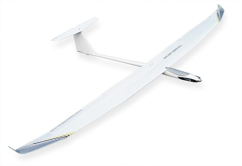

If looking for a more tolerant general propose 3 meter sailplane the Thermik Dream is a good all around sailplane with a much higher top speed.
