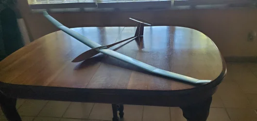

Funny you suggest that combo as that is exactly what I use on this 60" glider with 3/16" rubber. My main concern on the Tiny Tail is the shape of the bottom of the fuse. I'll use some good tape and since the fuse has been coated with glass and epoxy it won't do any harm. Probably more than can be said for my flying skills. You are correct, I'm probably overestimating the forces involved.
