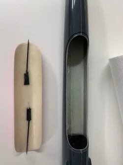

Like Wayne said, she is a keeper! Here are some pics from my build. MKS 6130 on flaps, KST A08+ on Ailerons, KST MS325 on Tails, 18650 Lilon 2s 3000ma battery , Needed 156 grams to CG at 105mm. 2530 grams ready to fly.
Keep throws low on this one, Elev-5mm up,7mm down(for crow comp), Rudders @ 10mm, Ail-10mm up, 5mm down, Flaps Down as much as you can get (I have @ 80 degrees) up about 10mm, Crow to taste, I have @ 5mm up on ail, full down on flaps with about 3mm down comp on elevator. Snapflap set to 6mm max, Reflex set on ail-flap, -1mm, Camber- down 3mm on ail-flap.

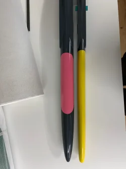

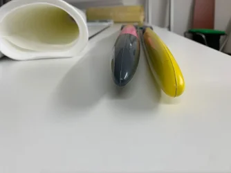

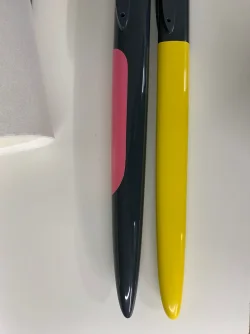

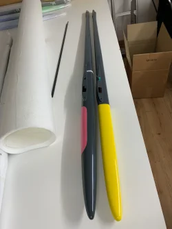

Some side by side comparison pics below of FS5 and Thor2 fuses

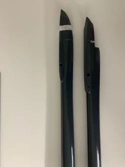

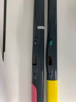

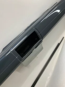

Yesterday, I received the first electric fuselages and hard-shell wings.
Due to time constraints, I was only able to take a quick look at them and snap a few photos of the electric fuselage. Over the weekend, I will take a closer look at everything...
I'm really happy with the electric fuselage! TJIRC has actually left the nose on, so this fuselage can also be used as a glider option. This is certainly beneficial for hobby pilots without competitive ambitions, as it leaves more space for RC equipment and allows larger components to be installed.
The disadvantage is that the nose has to be cut off for the drive itself. But this allows for a lot of flexibility... I will probably create 3D-printed templates for different spinner diameters and make them available as STL files and/or printed parts.
