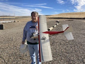

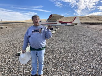

Yours truly with The A-Ray.
My first build in retirement, I've been dragging that kit around with me for over 30 years. Bought it at a garage sale which started 30 years of collecting kits to build once I retired. Now I get to build them all!
I built it old school with a single servo in the wing and bell cranks, rubber bands too! Covered with silkspan and Sig Koverall applied with hardware store lacquer and painted with fuel proof water based paint. Decals were cut out with my Cricut Maker vinyl cutter which also cuts balsa very well too.
Thanks to your help I hope to get the engine running (idling) like it should so no more dead stick landings, or fewer of them anyway. So far I've managed to get back to the runway every time.

It’s time to move up to the Anderson Trainer Master with its symmetrical airfoil. I also loved the mini Master on a schneurle ported 30 sized engine. Oh, then there was the sport H-Ray.
Love that you are using painted finishes!😍
