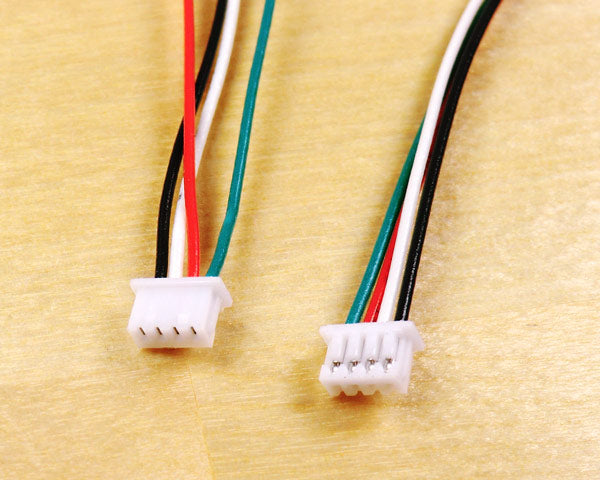

If using external sensors (Smart Port [S-Port]) please be aware that FrSky does NOT respect any standard pin output. This is another trap waiting to grab the customer!
Please see photo of the X4R and G-RX8 S-Ports
FrSky does provide adapters from the micro connector to the standard Jr style S-Port connector. But as the micro connectors are PHYSICALLY interchangeable it is still very easy to plug in the wrong adaptor cable into the RX.
Again a failure at the engineering level! Not sure why the PCB didn't bring the S-Port pins out in a previous defined order. But one would think a simple jumper would have corrected this.
I highly recommend that one label ones micro connector S-Port adaptor cables RX specific!

I do like the pin call out of the G-RX8 much better than that of the X4R as it isn't likely to cause a short should you by accidentally "force" the connector into the socket. You will note that reversing the X4R's micro connector will reverse the Positive (+) and Negative (-) pins!

Konrad wrote in an earlier message on this thread: "FrSky does provide adapters from the micro connector to the standard Jr style S-Port connector." Any idea where one might purchase those adapters? Or the individual micro connectors? I've been scouring the internet without success. Thanks!
These normally cost $40, but this should do it. Don't forget to re-pin the the micro block (easy to do with the tip of a #11 blade). The X4R and G-RX8 don't share the same Smart port pin call outs (see post #24)
You could add your own Jr connector
