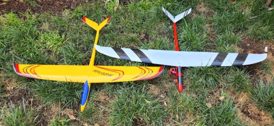

Now I know that you know about the stability issue with a large nose. That is why I showed the Schwing fuselage. It has the minimum front side area to get the job done. It has a rather large vertical fin to counter this area and give the ailerons something to work against. It is by far the best flying Aeroic design I own and fly. Not because of the cruciform tail but because it has adequate vertical area.
Doc, you made a gross error when you designed the Redshift when it comes to stability. Please Doc swallow your pride, and just own up to it. It will save us a lot of time and words. It might even help with the sales of the REDshift replacement, if you can show that the lesson from the REDshift have been learned. This time around what little I’ve seen of the replacement, it does look like most of the destabilizing effects have been minimized.
V-Tail problem? What V-tail problem? Just look below :eek:
LOL.
They really messed up on that design. When they added the larger wing to the make the Destiny. The TE drooped over the rear of the mount adding a lot of decalage also they didn't increasse the V-tail area to adress the added forces from the larger wing.
They did go the easy way out and not made tail at least bigger, but that Destiny is still a hoot to fly ( as long as you remember it's quirks) The micro Floh is a very nice flyer too. Even with the known problems the Destiny speed record is just below 290mph (!?)
