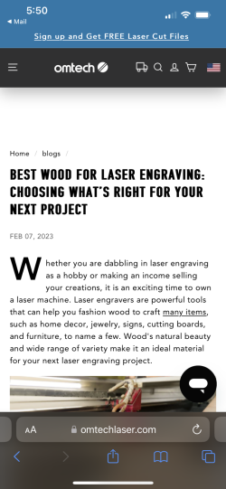

I do not know anything about this yet but the OMTECH website had an article suggesting this could lead to less charring on some very dry woods in addition to doing the things you mentioned. Being an absolute beginner ( the laser will not arrive for another week or so) I am reading up on the subject. Plan to use Lightburn running on Windows OS. Will be using a water cooling system and my workshop which is almost completed is equipped with major particle and fume extraction as well as a 5 stage filter system which will attach to the laser exhaust.

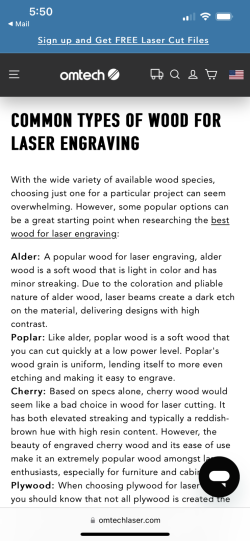

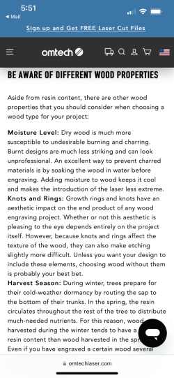

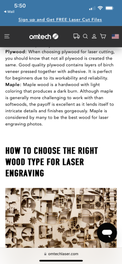

I am attaching screenshots addressing this that I got from the OMTECH website; again, I am a newbie to this. Last shot discusses wood moisture level and pre soaking.
Raymond

Not heard of wood soaking either. I'd avoid it for fear of warping and shrinking.

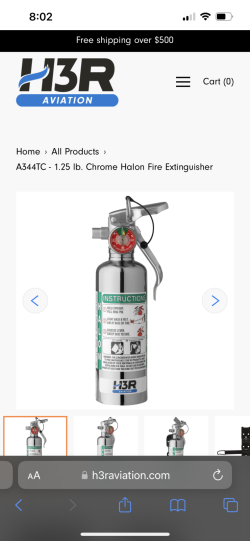

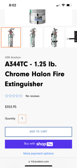

You can still buy Halon extinguishers but they are unbelievably expensive. However, for something as expensive and delicate as a laser cutter, well worth the expense.
Attached is a reliable source from the aviation industry.
Raymond
