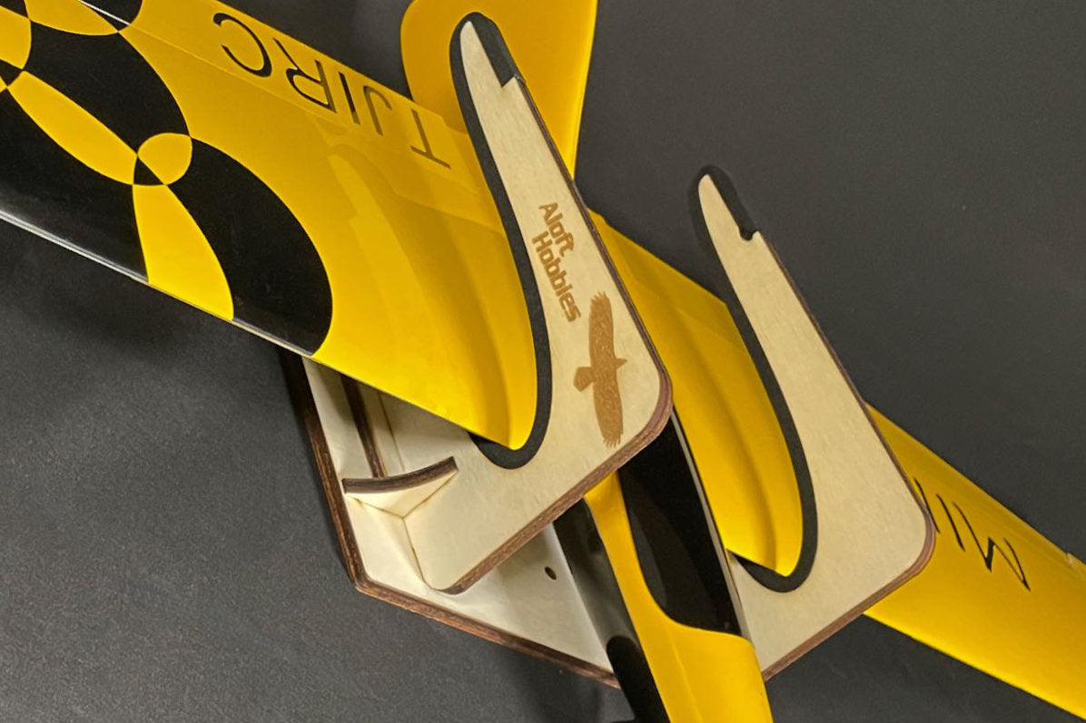

Don't get me wrong, the machine with tuning can do a wonderful job, here is a recent example:
