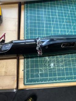

Had a 'hard landing' at Tick Point last week and broke the fuselage on my lovely Tempest. I would very much appreciate any repair advice or step-by-step instructions.

Oh no! Looks like it broke completely off?!
You could probably try a similar technique as I used for my Alpina repair. My damage was far less, but you appear to have much better access to the damage area.
Make a fixture/jig to firmly hold the two sections in alignment.
Grind the fuse shell thickness down from the inside, gradually across a couple inches on either side of the break so that the shell thickness tapers from full thickness a couple inches away from the break, down to say, 1/2 thickness at the break and then rebuild the shell thickness with glass cloth patches with alternating biases. Do the same on the outside.
While you’re working on the inside, you can seal off the exterior surface with painters tape. Ideally remove the tape when the inside layers are still in the green state and continue building up the exterior shell thickness .
Feather the edges of the new glass fiber into the old fuselage glass to reduce stress risers. Glazing putty works well for correcting any minor exterior surface imperfections.
Thanks for the detailed response - great advice! I anticipate it will be tricky to access the area once they are initially joined but we'll see.
Make some custom sanding sticks with bent ends to allow u to grind down the inner surface while the sanding stick’s handle sticks out of the hatch area. Epoxy brush bent 45deg about a 1/4” from where the bristles begin makes it easier to stipple down the cloth/resin.
The most time consuming part for me was re-aligning the fuse and stabilizing the distorted sections. The grinding and patching was surprisingly quick/easy
A length of 3/32” x 1/4” brass can be bent like so and some 80grit sandpaper added as indicated, to make grinding down upper areas of the interior easier
