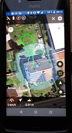

There is nice App in Google Play called "Telemetry Viewer" (Open source, so it's for free)
It does connect to Taranis via bluetooth and tracks the route of the plane/copter reading telemetry data.
I tried yesterday and it looks very promising.

my configuration: GPS-logger2; Archer R6; Taranis x9lite S (with OTx 2.3.7; Access; internal Bluetooth); Android Smartphone
Regards Alois
PS: due to bad weather and corona lockdown I could only do a simple test in our garden.
