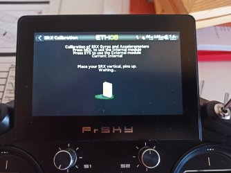

Hi All,
Having calibration issue with TDSR6 new receiver. Registration and bind went well. Downloaded the LUA scripts.
Going to SRX Calibration, face up no issue, face down ok, pins up - stuck on "waiting". I tried multiple times, no success.
I re-flashed the receiver, same thing.
See the picture. Any help will be much appreciated.

Same here ,,, as this issue ever solved? I get so far even Device config > Receivers > Stabilizer config and Stabilizer config is all OK 3.-3.
Scroll down to '6-axis calibration' > Open then is either stalls or falters after one calibration step.
Any idea?
OK guys I finally resolved this issue. Despite downloading the latest at time of recording 3.0.3 Rx software, I received a 'Success' message but this did not resolve my issue. I further re-loaded 3.0.3 Rx software again a second time and this time all worked. The 'Stabilization config' - 6-Axis worked for each correct tilt of the receiver i.e. top, reverse, side, top etc. PLEASE a plea to all YouTube and or Instruction makers,
