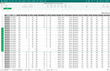

Hey Dave,
The log data shows that between 12:21:31.230 and 12:21:34.400, there were missing entries for both 2.4GHz and 900MHz RSSI and VFR. There was no interruption in the data for other fields e.g. GPS Speed. See the blank cells for RSSI and VFR in the highlighted rows below:
What I take away is that there was no general interruption in telemetry. And, since you didn't report any loss of control or failsafe (which surely you would have), I conclude the control link was unaffected. Or am I wrong about that?
Perhaps the "Sensor conflict" warning you heard accurately reflected a temporary and non-critical error condition in the RSSI and VFR sensors. It seems worth noting that those two sensors exist for both the 2.4GHz and 900MHz links in Tandem.
To the best of my memory, I've never heard the sensor conflict alert in many hundreds of hours flying with FrSky gear (albeit none with Tandem or EthOS). I'm not sure I can shed any further light on what you encountered.
That's a good observation. It does show the receiver was active during the dip in RSSI and that the transmitter could hear the receiver and I would assume vice versa.
The question is what would cause just a few channels to cut out like that? Have anybody ever seen something like this ? I wonder if the receiver load sheds when heavily loaded, and it dumped the telemetry when a higher level task was taking too much time....
A quick Google search turned up a number of EthOS bug reports related to the sensor conflict message, including this one which seems similar to what you experienced:
In that ticket, this post describes missing telemetry values along the same lines as in your log file.
The ticket is currently open so I suppose we can conclude that the devs haven't been able to understand and correct the underlying problem. Another bug report I came across suggested checking for duplicate sensor appID in the model programming. I didn't do a thorough search. There may be other relevant bug reports. ;)
The telemetry lost / recovered messages you heard about 30s after the sensor conflict may (or may not) be an important clue. I didn't see any evidence of a loss of telemetry in the log file to explain the messages. If there was an outage, it may have been shorter than the telemetry recording interval. Going forward, I'd recommend you reduce the interval to its minimum. Currently, it's about 0.25s. I think you can set it as low as 0.1s.
