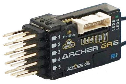

The Archer RX supports ACCST natively so no need for an external module. Just make sure both the RX and TX RF deck are running ACCST v2.1.xx.
OpenTX and RF firmware are 2 different animals. But it is suggested to update both of them. Just a warning, going to a newer version of OpenTX may kill your currently saved model memories.
Yes, your X9D can talk D8 and ACCST, it does not speak ACCESS. With this said, the Archer Plus receivers also also an option for you as they now support ACCST V2. So now you have even more options. (Just make sure it is an "Archer Plus", not the older "Archer")
