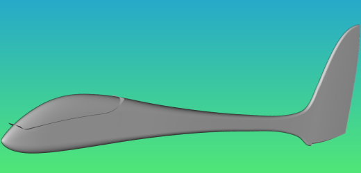

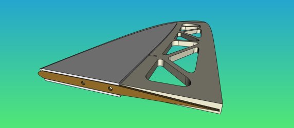

Hi everyone,
Just to give some update about how it's going on my side.
As a reminder, the goal for the coming alofthobbies kit of the Svolazzo V2 is:
- a fiber glass fuselage
- easier to build wing and stab.
The fiber fuselage design is starting to look good. Wayne is looking for availability of his fiber specialists before Alofthobbies can start to work on it.
I am quite happy with the wing new design. I was waiting for local laser cut to prepare my parts, he was in holidays. After he came back, we discussed about my files and the prices of its wood so I have nothing up to now, hopefully he will cut something this week.
Here 2 pixes, the stab and the fuse.
Stay tuned!

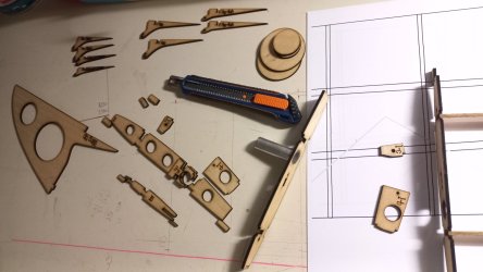

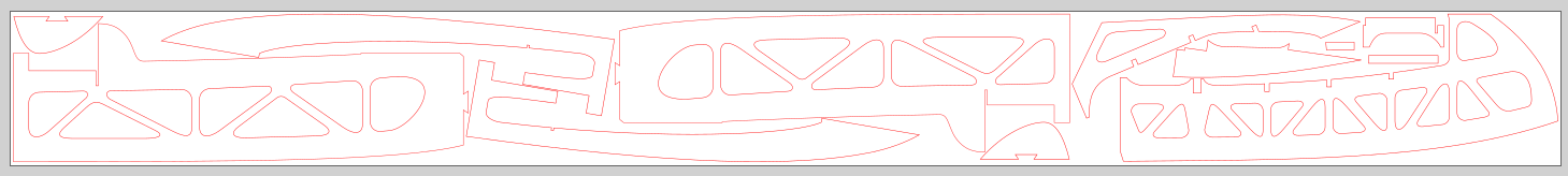

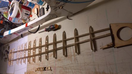

Hello,
Local laser-cut man has done first ones. 3mm balsa and 2mm plywood.
More to come, you can see the files prepared for balsa 6mm.
I will take pictures of building steps of this new design wing.
