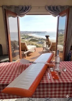

Way too much elevator throw. You will need to find the magic CG location AND correct amount of up elevator before you get to see any flight out of here. The CG and elevator throw work hand in hand. Very small changes to one at a time are the key to success. I'd throw the numbers into a CG calc and start with that EXACT CG location. Your elevator throw will be maybe 3mm, a very small amount, but you will need some reflex (elevons up) to get her to fly. I'd guess around 3 or 4mm up on the entire trailing edge.
Nate and I have both failed to find a flyable combination on planks we have brought in past years. Heck the maiden Mini Q took at least 30 attempts before stumbling into the magic combo.

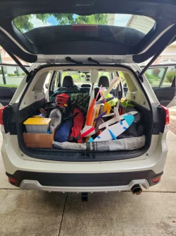

Thanks Wayne. It definitely needs dialing in but will be fun regardless. I can adjust all if that and will gladly take all input/help. Its loaded in the car now so wont be messing with it until tomorrow or Wednesday. Suprising how much fits in a Forester

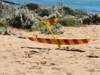

Little TD competition. Banana does the lawn dart thingee
