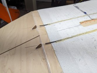

Yeah all of those types of glues are crazy strong. Much stronger than the whatever it is gluing together. And allows a lot of movement in a hinge. For the control horns on this ill probably lock the in to the wood by applying e6000 on each side of the hole/slot in the wood. Also dries pretty quick.
Control horns in place. I used e600 on the top. Once that set i dug the foam out around them on the other side. They stuck out thru the wood about 3mm or so and i poured some 15m epoxy in that area to lock them in place. Used those control rod tubes from aloft to get the servos as far forward as i could.

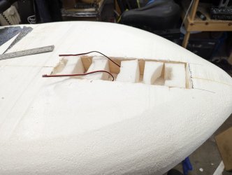

Dug out the electronics and nose weight bay on the underside of the hose. Glued in some ply side walls to reinforce the nose and used some left over EPP to push the ply into the foam while the Gorilla glue setup.
They are super thick, maybe 3mm so should be really strong. And i think i have some 20kg servos on the other end.
When in the neutral position the hole is right over the hinge line.

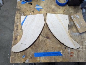

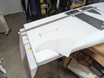

went with a balsa, fiberglass, foamboard, fiberglass balsa sandwich using epoxy as glue for the fin. Laminated enough to make 2 in case one snaps. Wanted balsa on the outside for some light rounding of the edges. And i was in a hurry so no vacuum setup
They came out at 60g and I still need to sand them.

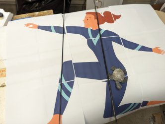

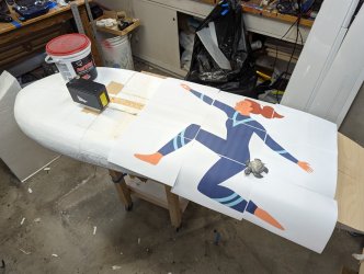

While waiting for things to cut on the hot wire cnc i have been working on the surfer. I printed out the surfer lady and started figuring out where the spars will go in the foam board.
I go the servos installed, but i think ill wait to do the elevon connections until after covering. Definitely enough movement even at the x20's stock 50% throw setting.
Just need to figure out where the wholes for the surfers carbon spars will go and i can spackle and cover it.
