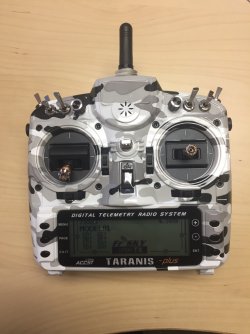

So we tried it out the X9E stubby antenna in the stock location:
I have to say I like the looks. Now onto the testing. As expected, this antenna worked fine with one exception, it has a dead zone where the antenna is pointing. During a quick range test we found it comparable to the stock antenna, but if the antenna is pointing at the receiver it suffered. This is true of most any antenna design, the best radiation is off the sides, not the ends. This is why the stock antenna folds over to the side. A 90 degree RP adapter could be used to fix this orientation, but probably better over to convert to the normal FrSky 2DB antenna. That is what we prefer.
