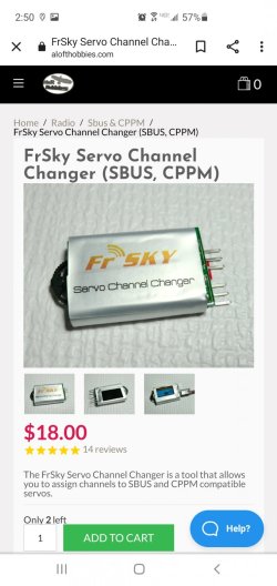

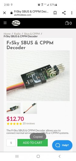

I added 4 more channels to my x8r pro by adding the following components.
The channel changer assigns what channels you want on the decoder. There are you tube videos to show you how. I added the most non-essential connections to the last 4 channels. Hope this helps.
