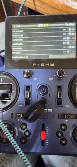

I have a couple of SR8 Pro Assess Receivers than I can't get the self-check to work. The Gyro works. but the self check is not highlighted when you go to the Sxr page. I sent a couple of pix. Does anyone know why I can't get the self check to work the blue light never comes on. Also I guess when you do a self-check the plane needs to be level, am I right?

Yes it needs to be level or slightly nose up during self check .. Make sure you have calibrated the receiver before the self check . Check your channel setups . 9 gain , 10 or 11 mode and 12 oops channel . I believe you need to be in stabilized mode also

Thank you for the info. I am more concerned about not being able to use the self-check in my radio. I don't understand why I can't get it id self check the blue light on the receiver dose not come on and the self-check is not highlighted. when you are in the SxR screen,
I know this is days later but I have noticed that while in the SxR or any of the other stabilized receiver screens they will not have the data. Turning off the receiver while keeping the radio in the screen normally fixes the data issue. Not sure if this is the case for you but it is an annoying issue with the current software.
