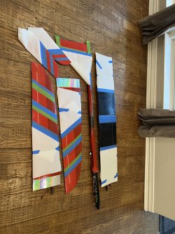

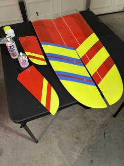

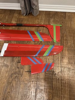

Sprayed some accent stripes on the Fazer. Got it used a few months ago. Flies great in light air. But the wing bottom is black and at a distance I was having orientation struggles because the dark red top and black bottom were way too similar.
Added a white stripe on the bottom and yellow fluorescent yellow accent on top. Fluorescent rudder too.
Pretty sure I could stop here and be fine, but thinking about a single coat of clear or wax or both.
-Any thoughts about whether or not to spray clear?
-If I wax it do I really need to wait 30 - 90 days like is recommended for new automotive paint?
-I’d like it to be slippery and durable.
Random info…

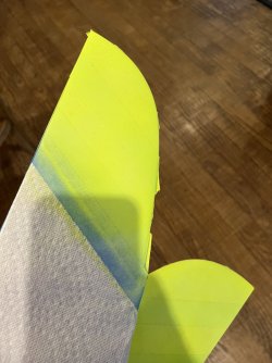

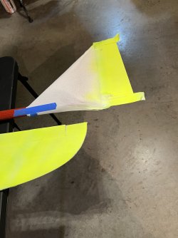

The key to making fluorescent pop is to spray it over a white base coat. I sprayed a couple of accent stripes on another dark plane before this one. Fluorescent spray doesn’t pop at all if it’s not sprayed over white.
A couple of light flash sprays is a big help. Go light.
On a paper test spray Tamiya fluorescent looked better than the Krylon or Rustoleum that I had. Expensive, but better brighter. And a finer spray. .
I did a light sand of the wing with 1200 grit before spraying. And a quick swipe with 3000 grit after the final spray dried to slick it up a bit.
The plane had a couple of strips of white vinyl on each side of the wing joints. Had been on for several years. Adhesive wouldn’t come off and adhesive remover was messing up the surface so I just put new reflective vinyl over where it was. Not what I was hoping for, but good enough.
The new blue tape that’s on there now I put down prior to the 3000 grit swipes. If I spray clear I’ll finish the tape job.
