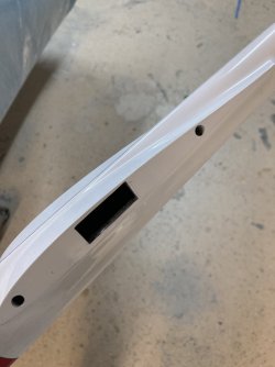

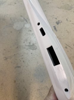

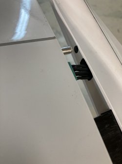

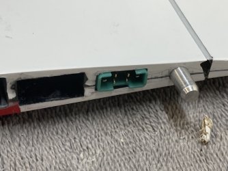

Got all the servos and hardware installed in the other wing tonight. The roots have a nice little pocket already cut out to fit the Graupner style connectors, they just needed minor filing to fit snug. I glued the connector in with thin CA. On the fuselage side I prefer to leave them loose. There is no precut hole, but a couple minutes with a Dremel tool and a jewelers file to clean things up fixes that.
All that is left now is to sort out the servo covers, set the CG, and do a final radio program. Weather looks calm here through the weekend, but I’d to try for a maiden. Fingers crossed.

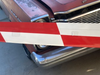

I ended up using a bump cover for the flaps and flat for the ailerons. Since the covers were all red, a quick tape line and some white rattle can made them blend into the scheme a little better.
