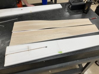

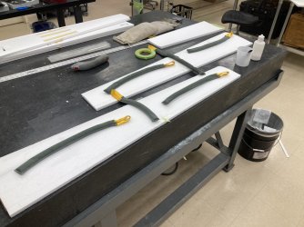

I finished the wing tube install and joined the inner and outer wing panels together. I added some filler over the joiner areas and routed a channel to run servo extensions. These will get sheeted with 1/32” balsa, so I trued up the sheeting edges, then taped them all together. I don’t pre-glue the sheets together. They will get bonded with epoxy resin, a little bit of carbon for reinforcement then put under vacuum.

@Red how often you get you granite calibrated??? It's going to be a fortune if you keep making your toys on it!! :devilish:
  • Haha
Good eye. This one was out of spec and was to be sent to excess. Not calibrated any longer but we snagged it, it's awesome for so much stuff!
I like $5+ snags! I bet moving it is pain, even with wheelsπŸ™ƒ oops your does not have wheels:ROFLMAO:
