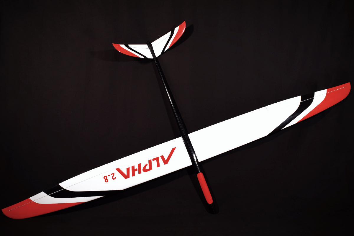

P.S.
If looking for an entry level 2.7 to 3m ship give the carbon Alpha 2.8 a good long look. At $850 it is a far better value than anything available from RCRCM!
