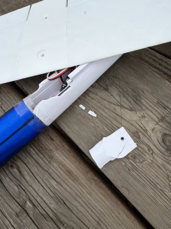

A friend bought a couple of SlingShots and gave me one and said I should come to the competition. I got the build done and went to Sunset Beach (California) to maidan. The wind was good…probably 15 mph (forgot my wind meter). I launched and it immediately went up…I didn’t even touch the sticks for about 10 secs or so. I was facing straight out and went to turn back in, which resulted in an immediate stall and crash. After further investigation, I forgot to set expo…I typically fly with 70% on all surfaces. I was so concerned on setting flaps and crow I completely spaced out on setting up expo. Dumb. So I believe I turned too sharply causing the stall.
My CG balanced weight was 572 grams at that time was 572g.

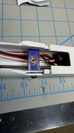

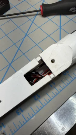

The crash separated the forward wing mount from the fuse and some hairline fractures in the fuse. I repaired by adding a block into the fuse for the wing screw to mount into. Here’s a picture of the wreckage and repair. Oddly the "all up" weight stayed the same. Note I did not add any of the extra carbon fiber rods like in the build thread. The wing hand sand marks but no damage from what I can see. I printed the nose cone from translucent blue PCTG...I did spend sometime trying to create the center wing panel so I could print it in blue as well....but it was taking too much time. I may just glue a thin blue skin on top.

70% expo? That is a ton. I only do that on crazy planes that are designed for massive throws. This is not that plane.
This model and many higher performance models do not like large elevator throws. The 70% expo suggests you have a lot of throw on your models and are using expo to make the model more docile. If you do have too much elevator, it will do exactly what you saw, put you into a deep stall, you probably would have recovered instantly if you had removed the elevator input if you had the CG around the sweet spot, but chances are you held the elevator and went to the ground.
For racing it is a good idea to fly with much lower rates than you would for fun sport flying. Seriously start at 50% of the throw and practice with those reduced throws.
I will be adding a mix on mine for my next outing where I get more elevator throw when my butterfly is deployed. Just need to figure out how that logic will work. This model does like extra elevator throw when the flaps are deployed. At this point it is safe to have the extra elevator input as deploying the flaps makes the wing very stall resistant.
