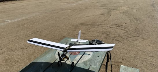

There is no mention of exactly where all the brackets go. As I recall there is one mention of how far back the front wing mount is from the end of the motor mount to give you a start on cg location. They are sensitive to cg changes. I am a glider flyer and honestly I do not find the Silly stick easy to fly. Luckily it is durable. Order extra props. They break on hard landings. Good luck.
