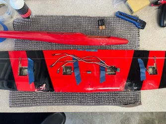

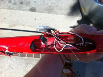

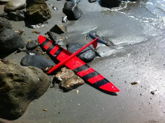

@Wayne when will you have wire harnesses for 1.5m planes back in stock? I've been warned against re-using the wire harness that was in my Genesis when it took an ocean dip at Fermin 12 or so years ago. I don't see corrosion on the main plugs, but most of the servo plug ends have some corrosion. I have some crimps arriving on Wednesday and may try to redo the ends (assuming corrosion doesn't seep into covered wires).

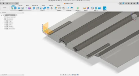

By the way, why are you sanding the carbon? Are the channels undersized and you just can't insert the rods into the printed parts? The latter has been the bane of my 3D printing life. A channel that is one or two tenths of a millimeter too small will ruin your day. (Z-wobble of a printer makes it even worse). Initially, I used long drills or files to open up the channels. It was a pain. I finally mitigated most of the issues by making sure that the design of the channels has a little "give" or compliance. There are no round holes, no completely square or rectangular channels in my printed parts and I almost never have to rework any channel anymore (or sand carbon fiber). Checkout the screen shot. It's not an original idea and I'm surprised that more people don't do it. I realize that's hard to do on someone else's design.

We are building these of the planes here, the rest went off to folks. Of the folks that built, and the other 2 planes here, no issues with channels, but mine has issues with the channels. We printed one set of wings here due to the rush, and I think I must have ended up with that set. The ASA likes a hotter bed than our local printers can do. The other issue is just dealing with so many carbons. I figured out the trick on the second plane. Trying to slide a panel over 6 or 8 pieces of .5mm x 10mm carbon is not fun, but sliding in one piece at a time is much easier. This kit has a lot of carbon! I'm going to go take a hot shower now.
