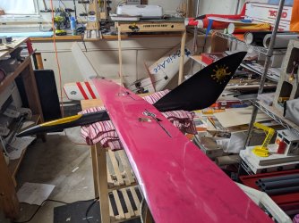

Started working on CG.

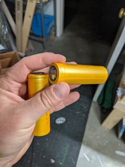

Big boy 28600's that @Wayne started selling will help get the weight up front.
Sweet! They are huge cells, aren't they?
Yeah they are nuts. I am trying to think about what i can use them for in the future. Heres a question for some one.
If one cell can do 30 amps, does connecting 2 in series or parallel double it to 60 amps? I am guessing that double the voltage does not but doubling the AH does but not sure.
You can double the voltage or double the amp rating, not both. Parallel will double the amp rating.
thanks wayne, not going to be a problem with just 4 servos and an rx on this project but would be fun to build my own pack for a bigger plane in the future.

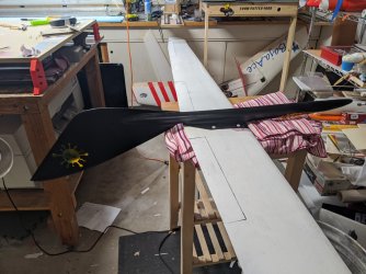

So all in all my expectations were pretty accurate - the AUW without battery, Rx, and CG balancing is 670g - the AUW balanced on the wing rod is 860g - my target was to be about 900g (like most of my ships) - the tail being 3D printed is a factor in this design as it is undoubtably heavier than a FG or CF tail - I think the true balance point was forward of the wing rod, so I think there is a bit of wiggle room to be under 860g - with a couple of lithium Ion 18650s there will not be too much lead to add at the front. :)
