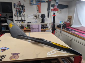

some more progress this morning - this time I attempted to pre-preg the CF tow and roller in the epoxy between foils - after that I placed the wing and trimmed the edges - the underside foil stayed on inside the bag and kept it all tidy while transferring the wings into the bag - so clean, no gloves required - we shall see in the morning!
oh yes, I remember flicking past that thread - nice fuse design. I will go and investigate further! :)
The wings turned out great (for a hand built job) - I dry fitted the rotor and wing rod with the slots all cut out and it looks good - working on the canopy as well (just a few tweaks to tidy the fit) - I think I will get it rigged up for a test flight before sanding and finishing. :)
Really coming along...
Yes, pre-wetting sure makes things easier. But I do suggest you keep the gloves on with Epoxy, the toxins from Epoxy can gang up on you over time. Keep that stuff off your skin!! Read up on epoxy tolerance sickness (something like that). Pretty nasty. First sign is you feel a little sick, maybe land in the ER. Not sure what the cause was, then feeling better you go back into the workshop and REALLY get sick.
@Wayne - you are right about epoxy - I have friends that can not go near it now - I do need to take more care as I am not as young as I used to be!
Yes a little ripper very chuffed! :)
