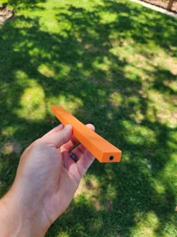

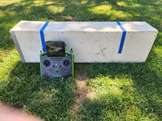

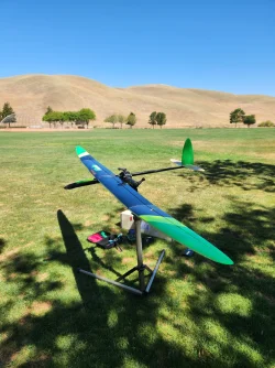

Viator maiden flight went great! Need a really calm day to fine tune it but caught a bunch of thermals and had to come down because I was getting tired of standing and looking up... 😅
I 3d printed a wing spar for it as it had a wood one that was home made and didn't fit very well. It worked great. Also amazing this 3+ meter plane fits in this small box. Lol

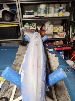

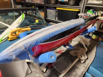

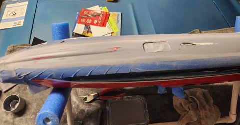

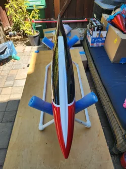

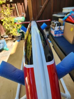

Been working off and on with the Kobuz since I did the maiden flight. Corrected a few issues and one of them was I needed to enlarge the main wheel cutout a little bit. It had some tape on the belly from a previous hard landing that broke the main wheel mount and scratched up the belly pretty bad on the pavement at Crows Landing.
I needed to remove the tape to enlarge the wheel cutout and figured I would fill in and paint the belly while I had all the tape off. Took some filler and a few coats of high build primer but were just about ready for color.
Did a wet sand on the last coat tonight and its looking pretty good. Planning on doing a white stripe down the belly so I dont have to try and match any colors and it will look good enough with the scheme. After thats done, Ill add a layer of clear abrasion tape to help with any more scuffs.
Unfortunately I didnt think to take any before pictures but here are a few in progress pics.

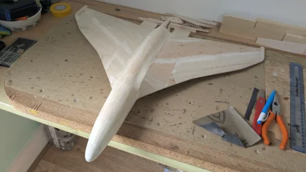

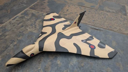

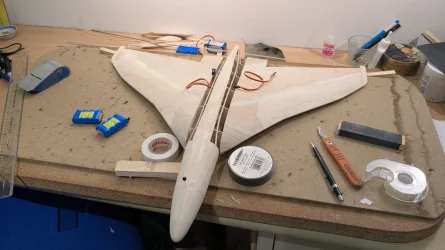

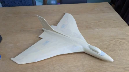

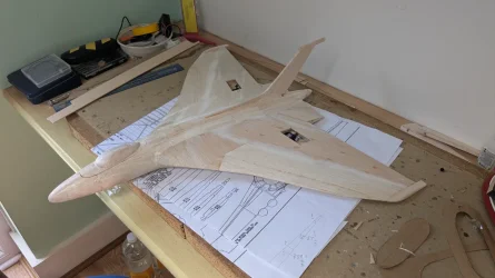

Hi - to all of you who wondered what my semi-scratch built Vulcan bomber from an earlier post would look like, here it is. It is built like an old-style Keil Kraft flying scale jet (off a Skyleader plan) but I then covered it all in 1/32in balsa sheet. After this was sanded and filled, I covered it in light nylon cloth that I brushed old style dope over. Finally, I covered it in Litespan - yep, that old covering where you brush adhesive onto the covering and the surface it is to be stuck to, before ironing it on. Lastly, I fitted a catapult hook.
25in span, r/c elevons and rudder, with an all up weight of 8 1/2oz. I've not flown it yet as it has ben pouring with rain after our drought broke :rolleyes:

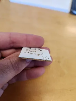

After a few years of looking, I was finally able to acquire a Gizmo 36. 😁 It will be going straight to the work bench when I get home today. Lol
It also had a fun little token from Tim (the original designer/builder of these).

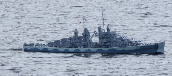

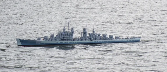

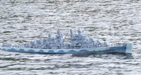

Bringing it down to Earth a bit. USS Juneau, 1/48 scale, 11. 3 ft, FrSky Tanden EX

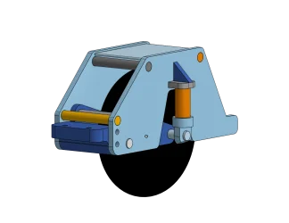

Well, after all the work I did on my CARF Kobuz to fix the scratched up belly, I flew one flight this last weekend, broke the wheel mount on take off and scraped it all up again on landing. 😭
Have to go through the whole process and make it look pretty again. I also vowed that I wouldn't have it happen again so I am designing my own fixed gear suspension mount for it. Already on V2 as the V1 worked well but was too long for the space I have in the fuselage. V2 is much more compact and should fit I believe. It is currently printing on my printer so we will see once I put it together.
I have a friend with a CNC so planning to have him machine the parts out of carbon and aluminum once I get the design refined. Been a fun project but really want to fly it again so hoping to get it finished up here fairly soon.
