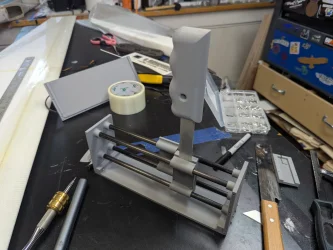

So they usually have hand controls for spoilers and flaps. The one pictured has small slider for trim. Some have pull strings tied to a button for tow release.

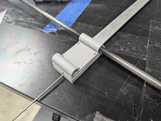

I decided to try and make my own version using an arduino controller and some 10k linear potentiometers i found with 100mm of travel.
Was going thru lots of different ways to get the sliding controls going and finally decided on 8mm carbon rods for rails.
Ill use 1inch x0.125 aluminium bar stock for the hand control to slider connection.
And probably just design in some linkage points for RC piano wire control rods to connect the pot to the sliders.
I designed all the parts in onshape free account. Finally figured out this morning how to combine multiple documents into one assembly to make sure everything had space to move.
This current version is just so i cant print it out to see what it looks like in real life, test clearances and get the electronics all in place to make sure its going to work. Ill add a enclosed box and more buttons in v2.

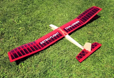

I completed an Astro Flight CHALLENGER kit and flew it yesterday.
A 72-inch polyhedral motor glider designed and kitted in the USA.
Happy to report it flew great right off the boards.
Three "personal touches " in this build:
1. Flow through motor mount, using the X-mount that comes with the motor.

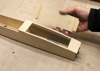

2. A no-hardware , no rubber band, hatch mount method. Cross grain plywood.

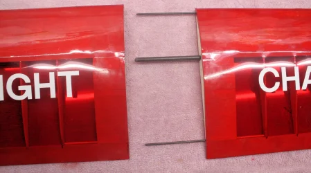

3. The anti-rotation pins for split wing joiners are structural. Because, why not?

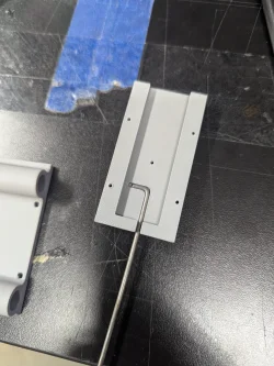

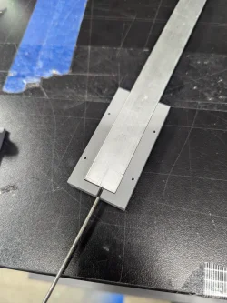

little more work on my glider sim controls. Decided to connect the hand controls to the sliding potentiometer RC style with control rod and a z bend on the pot. Actually got the diameter for 2mm piano wire right on the first print.

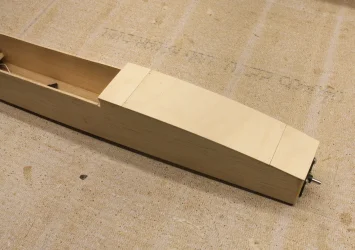

Printed out v1 of my glider controls. Immediately found 20 things i need to fix. Already printed out v2 parts, just waiting for some bearings from amazon to put it together.
Got my 100mm sliding potentiometers and had to figure out how they worked with a multimeter which was actually pretty fun. Seems like a lot of pots have the 3 legs all together so finding the middle one is simple. On mine one leg is far to the opposite side. Quick google search on how to verify with the ohm setting on the multimeter and i got it figured out.

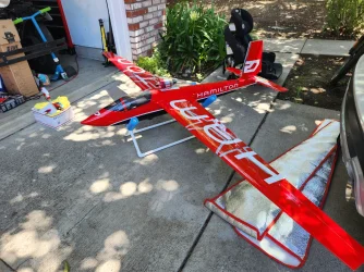

Newest addition to my fleet. Its well used and has multiple repairs but for the price it should be a fun way to try flying an F5j ship. Largest thermal planes Ive flown are my 1.5m DLG so really looking forward to trying this out.
3.16m span, Mantis 45A ESC and KST servos. Not sure what motor but Ill check when I receive it.

Making some progress on my Condor soaring sim hand controls. Since last post i have printed and built a v2. Found things to fix, printing out v3 of it this morning.
After looking at the setup for condor i found that they only let you use a Axis/slider on spoilers and pitch trim. So i modified v3 for some push buttons for Flaps up/down, landing wheel toggle, and tow plane release. The reason for 4 buttons is i decided on the ultimarc U-hid as my usb controller and with 2 pots i have room for 4 buttons.
Heres a demo of the u-hid mini and 2x pots. It just shows up as a game controller in windows.

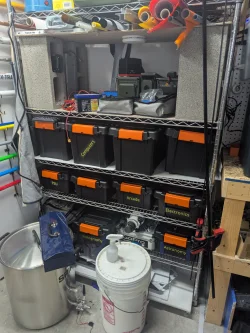

Organization continues. Grabbed some 3 and 5gal containers from homedepot.

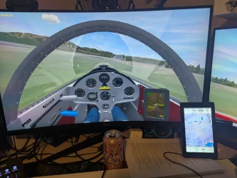

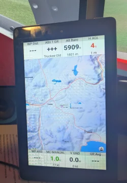

Was playing around with Condor flight sim last night. In the sim there is a PDA, but its kind of hard to see and the keyboard buttons to use it are a little hard to use. So i had been looking to make another button box just for using the PDA in sim. Well than I went off on a google tangent about using XC Soar with condor. XC soar is an open source flight computer mobile/pc APP used by GA gliders and paragliders. Has modes to help you stay circling and find lift, do you have enough elevation to get to your next task, competition tasks etc. Tons of options for how you want all your data displayed. Apparently you can setup the gps device settings to accept TCP network data instead of a physical gps unit from the vehicle. Condor automatically sends this NEMA data to a com port on your pc. And since Condor uses real world locations, you can just use the built in maps on xcsoar. Wasnt too hard to setup, just had to find a virtual comport program. Heres it working on an old fire tablet 7:
