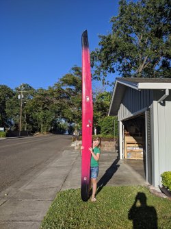

Final weight on the new planky is 1.2kg, 1.8m

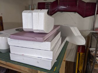

Had some time after house chores yesterday to play around with a bronco cut in the CNC. 48" wingspan, will be powered. Probably sand in some more details but not going really scale.
I like the look of the bronco. A little shaping will really bring out the essence of the plane.
hank
I was just discussing with my friend what would happen if I tried doing a quarter or half inch roundover bit on my trim router to soften the edges. I'll try it on some scrap foam and see what happens

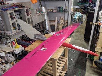

VERY VERY NICE!
Next time you might want to bias the fibers at 45° to help control the wing's tendency to twist. I know this cost more in materials.
I think doing it the way you did is fine for learning how to bag, as it is much cheaper and more than adequate.
