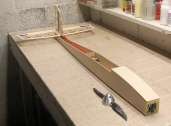

1,2. Building an older kit, but with three new tricks.

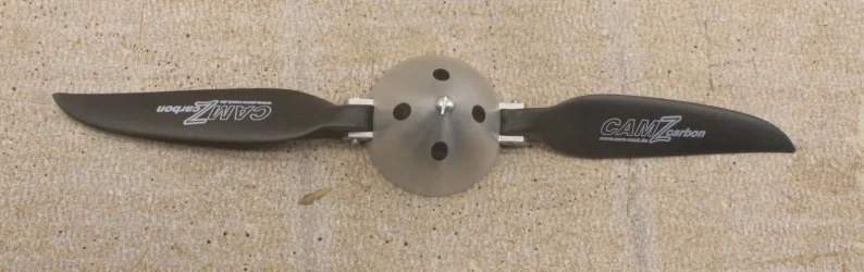

7. Holes in spinner for airflow

Curious if that spinner will whistle a little. :) How the heck did you drill the holes in the spinner?
The holes were cut with an end mill, while the spinner was held in a custom fixture.
I am indebted to a machinist flying buddy for the idea, and for the execution of the work.
Interesting question.
And will the pitch change as the motor speed changes?
I'll mention my findings in the eventual flight report.

After finishing the Puddle Bug I decided to do another small build. I’ve had this Micro Sagitta kit for awhile and I put it together. I made new spars from 1/8” sheet (I don’t like notched spars and my thoughts on that can be found in the mini wanderer thread). It is a nice build. I will add carbon tow to the bottom of the wing, I will make a small up start.
Covering up next.
Hank

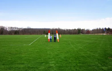

We got fresh covering on a pair of old reliable RISER-100 wing, just in time for our first day of truly spring like weather.
One on a SigMfg kit wood fuselage, and one on a Topmodel PRELUDE fuselage.
The long shot shows why we don't generally need spoilers for landings in this field.
As long as we remember Dennis Phelan's observation, "Walking is part of soaring."
