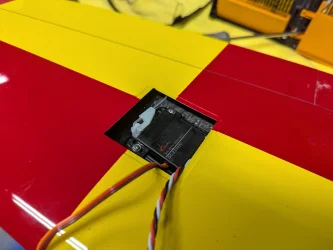

Took me a while to figure out how/what to do with the servos on the aeroic gremlin wing but got an aileron servo in finally. Next 3 should go fast.
Went with threaded rod to plastic clevis on one side to L with keeper on the servo. E6000 premium glue
I was going to try and use the metal clevis but its geometry is like a triangle, its really wide where the pin is and i didnt want to keep making the whole thru the wing bigger so i switched to the plastic clevis you guys carry which is more like the shape of an H and much thinner.

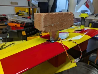

After thoroughly searching all shapes i came up on the little shot glass that is pretty perfect. The base is just slightly smaller than the diameter of the servos, so will fit into whatever whole i made for them, and the top of the shot is wider so it helps keep things stable. I probably should find something rubber coated though instead of a brick. I think this was a "how many minutes till i need to leave for work? ok lets do this real quick" moment.
I think all of us have some adapted tools which become invaluable. I have some large EPP core shucks that seem to fit most wings pretty well.
I also have a large collection of 1-2-3 blocks now. I don't think I could live without them.
