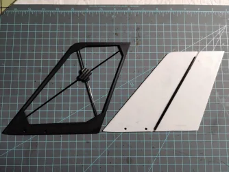

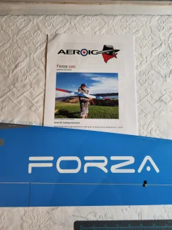

Hey everybody, could use some help from the collective minds... I am finishing my Z1 build but have run into a problem. The kit I got was missing the vertical fins for the wing tips and I have been trying to come up with a light yet ridged design to 3d print. So far, I have failed miserably. I have attempted 3 or 4 different designs but each has had its own problems. The two most promising designs I tried were to make it with an empty center, with carbon tubes added for rigidity and then cover it with clear covering film or a mostly solid fin with a groove for a carbon tube from the bottom to the top.
The light ones with the carbon tube supports seemed alright until I went to try and cover one. Im already not great at covering and the film, combined with the heat from the iron, caused the fin to warp. Granted, I only attempted one side, but I dont think that I can get a strait fin with this method.
Next was the mostly solid fin (hollow inside with sparse infill) with a groove for a carbon tube running from the bottom to the top. These turned out heavier of course, but seemed somewhat ridged and I had high hopes when I glued in the carbon tube as they were very ridged. The problem came when I installed them and with it mounted on the wingtip, they flex a lot due to the small mating surface where it bolts onto the wingtip. So at this point, I scrapped this idea and came here to see if anyone has a better idea for me to try.
The light version with carbon came in at 23 grams per fin (uncovered) and the heavy ones came in at 33 grams per fin. I know the factory ones are sub 10 grams which I can not achieve by printing but I dont have the skills or materials to vacuum bag balsa fins. Any thoughts would be appreciated. Or if you know of any pre-made fins that might work I would be happy to explore that route too. Or best case, someone has a pair of Z1 fins maybe??? :)

*The carbon tube isnt the full legnth of the fin because this was a test fin with a scrap piece of carbon for proof of concept

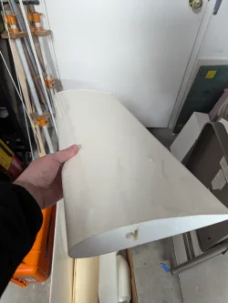

OK - I had liked your 3D printing approach, but sounds like that isn't going to cut it. It is hard to keep the weight out of 3D printing compared to balsa. So here is my suggestion, go back to balsa. Very easy to work with, and you do not need to bag them!
My thought, basically duplicate the factory tips with balsa and a little spruce or lit ply at the bolt areas. Glue that and sand it nice and clean, then just cover it in normal shrink film. This is the easiest method. The film should make them stiff enough. They may be a little more fragile than the factory units, but will be easy to produce.
Plan B would be to due the above, but after sanding you can do the poor man's glassing method of using a bunch of thin CA, let it soak in and cure, then sand that back. You can leave them bare if you like, or paint or cover. This is more sanding but you would be surprised how tough this gets. If this is still not strong enough, add a layer 3/4 oz fiberglass. I have a lot of this here, if you like I can send you some.
I think these methods are simple and quick and will work very well for you.
But yes, you can bag with the wife's food vacuum bagger, but bagging is a new level if dificulty IMHO that isn't really needed for this application. But if it is a skill you would like to learn, DO IT!

Thanks for the help guys, Ill have to dig through my stuff and see if I have any balsa sheet I could use. What thickness would you suggest? Was thinking 1/8 might be too thin but 1/4 maybe too thick? Obviously I could sand down the 1/4 some and it would give more material to work with. I just havent done much balsa work before so this will be new to me as well. Thanks again!
I believe the originals are about 1/8 thick. Try using 1/8 balsa and maybe try some 1.7 laminating film to strengthen. That stuff doesn't shrink much.

Thanks for the breakdown Wayne, I will be placing an order today for some balsa and a couple other little things. If you have some scraps of fiberglass sitting around, I would gladly take some as I think I will try bagging a set since it is something I have wanted to learn. I will also make a balsa/covering film set in the likely event that the bagged ones fail miserably. Lol

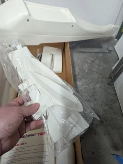

One of my friends i had not seen in a while gave me this old Lanier kit. I know i wont get to it, anybody going to Sunset interested in it?
