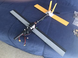

I made this because of my fear of wrecking the better replica I'd built. It has a 20mm Carbon fiber fuselage. Everything else is mounted on 3D printed fixtures which are threaded on to the tube and can be adjusted longitudinally for CG. I finall worked up the nerve to try to fly it. I chose hand-launch and quicly discovered that this was a good way to get a torque-roll induced crash. Without significan power, it wouldn't fly for long and with, I'd get the roll. It looks like wing loading is the problem and since that cannot be fixed without either building lighter or diverging from the intent to make a flying replica of AeroVironemnt's SwithcBalde300.
It looks to me like a solution is to catapult launch. I'm thinking of the Wright brothers' system witha falling weight. If the weight only falls 8 feet, I'll only see at max 20 mph, and I think i need at least 30. I can multiply the fall by pulleys which with a big enough wieght ought to get the job done.
so an 8 foot tower and a 6 foot ramp is where I'm going.
I'd thought about bungees, but couldn't see a way to deliver the thrust except with maximum right at the start which might be hard on the plane.

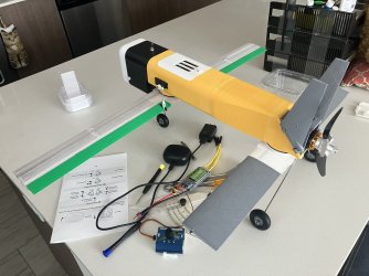

Second photo is the replica - with landing gear. The runway at my new field is very smooth and it may be that I can run this up to the 30mph on the ground and rotate - hopefuly and fly.

With the greatest of respect and admiration for all that investment in time, hard work, and obvious application of brainpower, why?
Dont we normally try hard to make our gliders - or power planes - as beautiful as possible?
There can be intrinsic beauty in mechanical structures, and I am quite sensitive to that, but in this case - again with great respect - in this project I dont find any.
What does get me though, is a huge curiosity to find out why someone such as you with an obvious mechancal bent and love of modelling should want to make something so weird that even if totally successful - with the design needed to fulfill the role - will have no hope of flying very well.
Again - I admire what you are doing, but I'm afraid I dont understand it.
Really I'm not decrying here or trying to put the project down, but can you give me a clue?

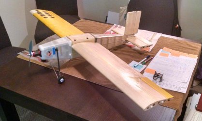

DocJ, no offense taken. I think I did it because I thought it would be difficult, maybe impossible. Here are a couple of shots of an earlier more conventional project. airfoil is Gottingen 418 - center section of Fokker DVII upper wing. ribs cut on cnc router and assembled using 3d printed fixtures in photo - covered with 1/32 balsa. I started out with about 3 degrees angle of incidence which turne out to be way too much. none worked fine. flew very nicely bogth fast and quite slow. It was my other scratch design-build. ailerons driven by carbon fiber torque tubes from servos in fuselage.

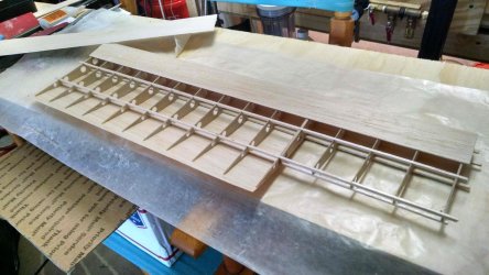

partially build wing. I thought I was going to need full length carbon fiber spars 10mm and 6mm, but it turned out to be so stiff when it was skinned that i was able to get by with 6 inch stubs. enough to engage 5 ribs iirc.

Hi Doc, maybe I didn't explain it well. The version with the 20mm tube was designed to be easy to rebuild post-crash. and it is.

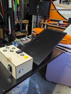

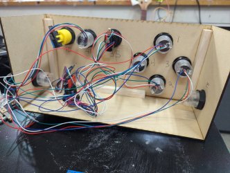

Did cut out and work on a little virtual pinball test bench to see if i can get it working before moving to a more solid setup:
