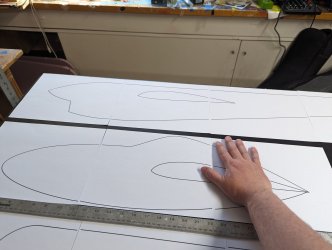

Went thru some balsa plans on Aerofred and found ones i like. Traced out the parts in inkscape and scaled them up for a 2m wingspan. I did shorten the main wing root just to make it a little faster.
EPP wings. Fuse parts will be balsa core with epp sheets on each side.
Going to go with a thinner profile version of the fuse and motor sections.
Airfoil suggestions?

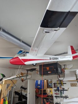

Ka-8 hung up and ready for maiden. Only mod was some 3mm kite rods on the bottom of the wing
I wanted to see what the IRL size of a 2m P-38 was so i printed out the fuse parts. Original airfoil left on for incidence stuff later. Will be using MH32 on full build.
Think im going to make the wings removable just past the motor pods. So when broke down the main part of the plane will be like 29" wide.
One half of the wing is 1 meter/ 39 inches and ill beable to remove 24.5" for transport.
