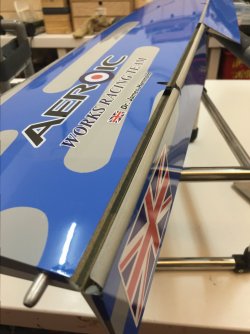

Aha...I'm not sure, but I think I might be the inventor of this type of gap seal MANY moons ago while still living in the UK in the late '70's with vac bagged wings.
I'm not doing any right now otherwise I'd just publish some pics.
I do remember that Joe Manor did make a really good "how to" gap seal/epoxy wiper video if someone could find it?

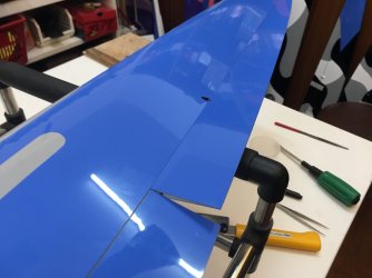

Here is an out of workshop mockup.
Basically it involves taping a mylar strip to the top of the control surface so that it can be slipped into the gap inner space.
Then cabosil filled epoxy can be applied inside and smoothed before carefully pushing the mylar and tape inside the space. The control surface is then deflected about 45 - 60 degrees then taped down to let the surface of the mylar follow a radius while the epoxy mix cures.
Note that this picture is just painter's tape to show the method - the mylar is stiff and makes a far nice radius.
After that, take off the mylar and painting tape and sand the front of the now hardened wiper true.
Otherwise next time I do some I'll take pics.
J.

That's the process I recall. Too much epoxy and one has a permanent spoiler and shy on epoxy looks like crap.
I assume you use double sided tape to attach the mylar (acts as a glue seal keeping the epoxy off the lower skin of the control surface). The bottom of the wing can be cleaned up with solvent prior to the epoxy setting up.
I guess I'm just have to man up and do it! But I'll look for that video first.:rolleyes:
permeant
Actually Konrad - once you get into it its not too bad - and yes its best to use double sided tape.
If its your first time, I'd have a lot of wipes and alcohol (the solvent kind) close by.
Also, using a small plastic bag like a cake icing piper helps a lot, and allows you to carefully control the amount being laid down. I tend to keep any tapered tubes that come on the tops of glue or sauce bottles for this job too.
Cut down and inserted into the bag then taped up or rubber banded tight to form a nozzle, they do a great job and are a little bit more controllable than just a plastic bag with a hole in it.
Also, also (!) having a shaped "spatula" to scoop off the excess epoxy helps too. I use those ice lolly sticks sanded a bit to shape. Hmmmm - "Lolly sticks" - is that what you call them in the USA?
"Resting" or using the tape to "guide" the spatula as you move along the control surface helps to get a nice even curve inside the epoxy radius and tapers it off nicely (with a little practice) towards the front.
I normally do several "scraping" scoops to get rid of most of the epoxy I don't need, as there is always too much. Then I do a final finishing run along the entire radius to define the final shape.
If you are super nervous it might be an idea to do a mock up first, using some shaped bits of wood or something to simulate the job, and let you get a bit of practice. Pretty easy to make I'd guess, and you can clean them and try again until you think you have it sorted.
After a short while you get pretty good at it.
Hope it helps!

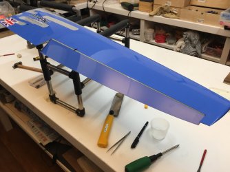

Here are the last pics which are self-explanatory.
Conclusions:
This is a pretty good system that once installed is very solid and slop free, but also accurate and gives a nice lot of movement.
Its a REAL pity there are no instructions as to be honest its not rocket science, but a first time installer could sure cut a lot of corners and save a lot of head scratching time if there were some.
I'd use it every time if I could fit it in.

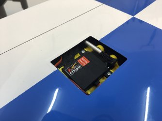

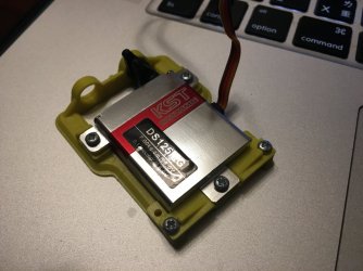

I don't have photos of a full install, but here are some pictures that show the basics:
Detail of the bottom:
Using an existing control horn:

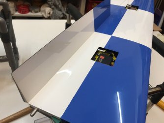

Using the internal "spoon":
Pay attention to the geometry of the spoon, the taller side goes away from the aileron/flap hinge. In this picture, the hinge would be on the bottom.
You can get a lot of throw that is very controlled when using the spoon. Best of all, the linkage can be contained within the wing, no extra drag. I honestly find these a little easier to install. The servo tray is about the same as a normal tray. The spoon just needs some material removed from the inside of the flight surface, then it all glues in.
The servo arms on these are one of the other neat tricks on these, they supply different lengths to get the amount of movement needed. You will probably be good with one of the very short arms if you are using the spoon. The cool thing about the arm design is you can use the full forward rotation of the servo without any worry of the linkage hitting the servo arm. No more crazy bent linkages and ground down clevises to clear the wing skins, etc. Yay!!

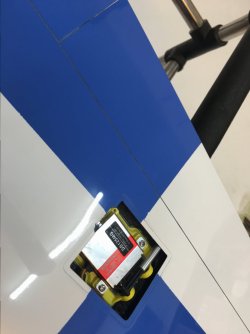

Just noticed - on Wayne's pics, the small back bracket shown on this assembly is upside down. That will make it impossible to remove the servo from the wing. It should be the other way up with all the servo mounting tabs screwed in from the top.
See what I mean about the lack of instructions?

This forced me to take a look at the IDS servo trays. What is real nice about these is that they allow for some real small servo arms that allow us to use the full mechanical potential of the servo. This means being able to maintain the servo's resolution and power!
https://alofthobbies.com/ids-servo-tray-for-kst-integrated-drive-system.html
Luck would have it that the external bearing tray and IDS use the same servo mounting tray. This was nice as I had already glued the servo mounting tray into the wing.
