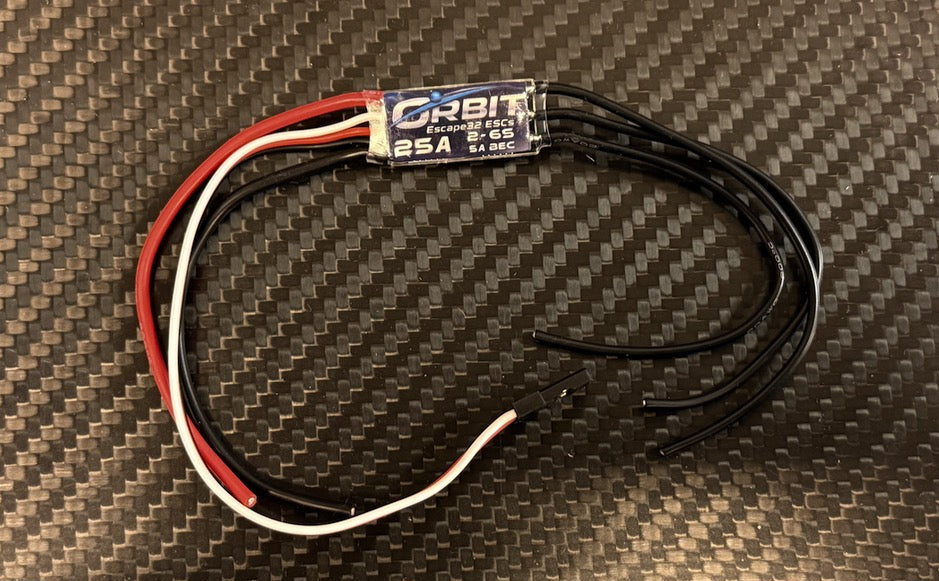

@Wayne I tried to order some of your 25amp Orbit ESCs but they were out of stock. Any idea when they might be available?
In the meantime I ordered some of the 60amp units. I'll compare to the 70amp units I already have.
Thanks!
Thanks!
Actually we have a few, they weren't in the system. Go ahead and order.

@Jarron thank you. However, I'm unable to place an order. The button that would normally say "Add to Cart" is grayed out and says "Sold Out".
Let me know how to place the order. I'll grab three if you have three, or two if that's all you have. In terms of settings, I'd request that these be set-up for normal airplane mode (forward only), drag brake 50%, LVC 3.0v per cell. I am not aware of any other settings that need to be changed but if you are, please change them.
