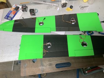

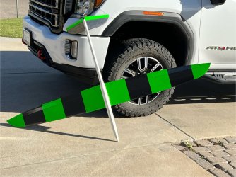

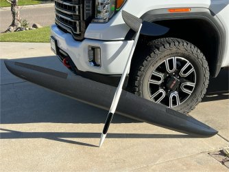

Is that simulated carbon covering, or actual carbon?
If its really carbon you might like to think about some protective wing bags for those sunny days, waiting for wind.:cool:
Looks Like the Carbon fiber iron on covering offered from Aloft. I used it on a nice flying wing build. Looks great IRL.

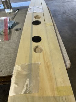

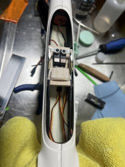

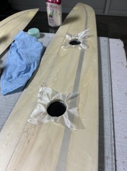

Sequoia 2 meter. new to all this plane building could use a few comments on servo placement. Did I need to go to the trouble of the fiberglass in the servo holes.
Fiber glassing the holes is good practice. It gives a firmer more stable mount to the servo and it puts back some (not all) of the strength lost when the wing skin was cut.

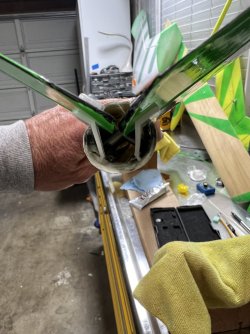

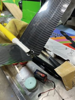

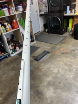

Still needs a little adjustment.

yes Those magnets are holding the sleeve in place, tried using the little push wire but the ' magnets wouldn’t hold so I replaced it with a welding rod , dripped the glue down the out side of sleeve and just like that done .
