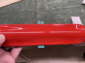

I'm liking the tape method more and more. But if you are willing to go through all the trouble of installing the hard ponts for eyelets these make great wing locks.

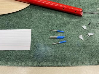

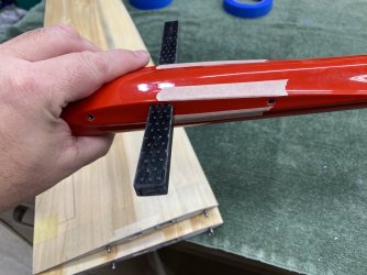

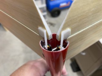

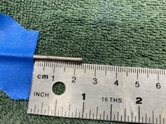

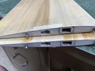

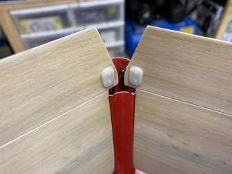

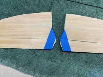

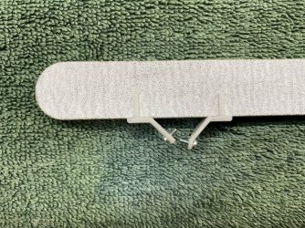

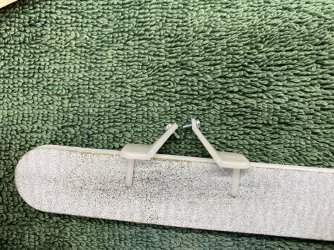

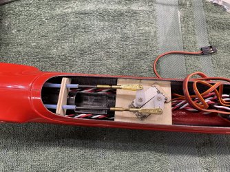

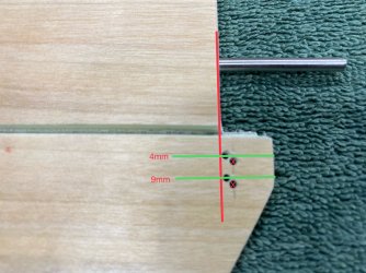

Hopefully this is helpful, the angled horns actually seem really nice, unfortunately, they rub the bottom of the fuse, so I trimmed them 2mm which moved the ball links up. The ball links also hit not allowing up elevator, so I had to put a second set of holes. Not sure if the horns full length would work in the new holes.... too late. The tubes to hold the stabs on require 23mm exposed, so I wrapped with tape, put a little epoxy in each hole and used the drill to slowly drive them in to the tape. Epoxied the horns on as well and pressed the tops in place. Ball links are from twisted hobbies, the smallest I’ve ever seen. They look great in this application. Shaved the roots of the elevator to keep them from hitting.

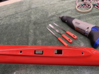

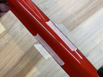

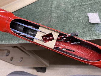

Did a bit of grinding and filing this morning. Got the wiring harness mounted in the fuse. Need to shorten the aileron wire about 5”, so after that, I can secure the wing side.

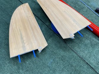

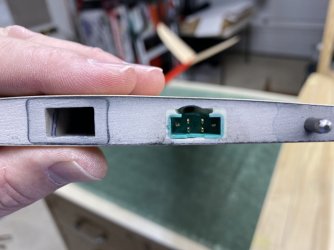

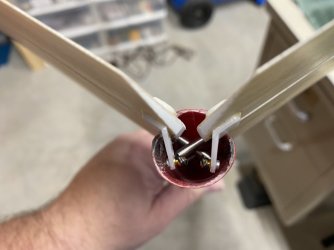

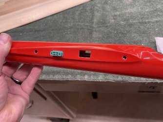

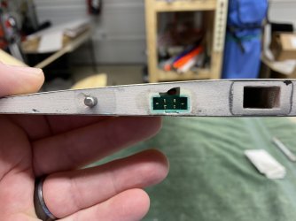

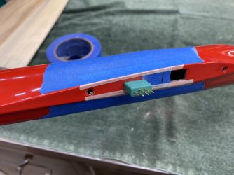

Got the V-tail linkages done. Came out very clean and smooth. The ballast slugs drop right down between the pushrods. filled around the Multiplex connector with microballons and epoxy. Didn’t like how thin the material was that was left... the connector is structural now...
I really love the lines of this sailplane, I hope it flies as good as it looks.
