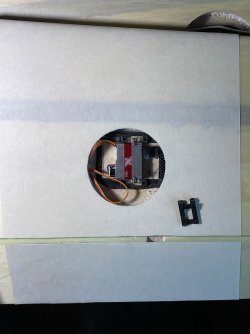

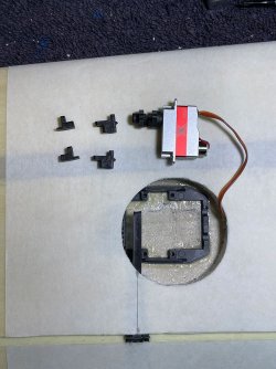

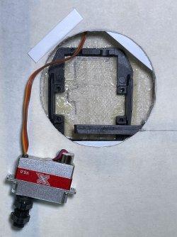

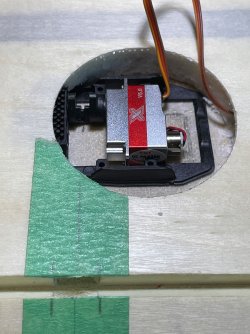

Here are some shots of the wings, the ailerons and the flaps. I decided to install the servorahmen IDS kits to keep the beautiful wood finish, and it worked out nicely!

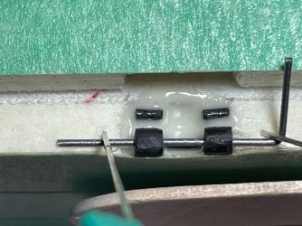

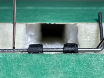

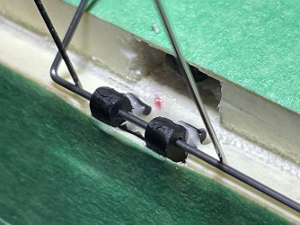

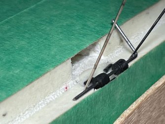

Closeups of the epoxying the hinge in the flaps. More to come later...

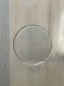

Soft glued the servo circles onto the little "shelves" I made, nice and flat! Ready for the maiden voyage, but weather is bad... ;-(
